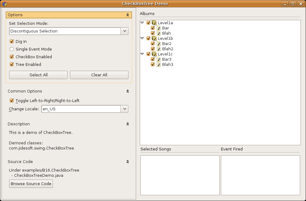

Here is the original list after starting the sample app I had modified and provided in a previous post.
I modified the valueChanged() method to this
   public void valueChanged(TreeSelectionEvent e) {
      boolean dirty = false;
      TreePath[] paths = e.getPaths();
      TreePath[] treeSelectionPaths = _tree.getCheckBoxTreeSelectionModel().getSelectionPaths();
      if (e.isAddedPath()) {
            dirty = isCheckBoxListSelectionChanged(e);
The CheckboxList after starting the sample app.
When I click on the checkbox for Level1c - Blah3 I get the following
paths = [[Root, Level1a], [Root, Level1b], [Root, Level1c, Bar3]]
treeSelectionPaths = [[Root], [Root, Level1a], [Root, Level1b], [Root, Level1c, Bar3]]
This makes sense as blah3 has been unchecked. the treeSelectionPaths says that all nodes under level1a are checked as are Level1b, but only Bar3 is checked under Level1c. completely correct.
Now, when I click Level1c - Blah3 again, to re-enable it...
paths = [[Root]]
treeSelectionPaths = [[Root, Level1a], [Root, Level1b], [Root, Level1c, Bar3], [Root]]
Neither of those 2 values seem correct. treeSelectionPaths says that all in leve1a is checked (correct), all nodes in leve1b are checked (correct), but that only Bar3 is checked under Level1c (incorrect as I just clicked Blah3).
Looking at the same values during the 2nd call to valueChanged() for the same click on Blah3. This is where I ignore this call by the "if (e.isAddedPath())" check
paths = [[Root, Level1c, Bar3], [Root, Level1b], [Root, Level1a]]
treeSelectionPaths = [[Root]]
This is still incorrect. The paths that are returned should be [[Root, Level1a], [Root, Level1b], [Root, Level1c]] to show that all nodes are enabled.
At no time do I get a correct listing of paths that show all nodes are enabled during valueChanged() time after I re-enable a previously unchecked level2 node.

Postby JIDE Support » Fri Sep 18, 2009 1:38 pm
It is kind of confusing however it is a correct behavior. First of all, please look at the value in the event, which is printed by your code with the prefix "paths = ". The values with prefix "treeSelectionPaths = " is not a final state at that event.
When you unselect Blah3, the value is like the following, which means, Level1a, Level1b and Level1c/Bar3 are selected. Correct.
When you select Blah3 again, the value is like the following, which means, root (including all nodes) are selected. Correct.
paths = [[Root]]

Well, I stand corrected. the paths value still isn't always correct either.

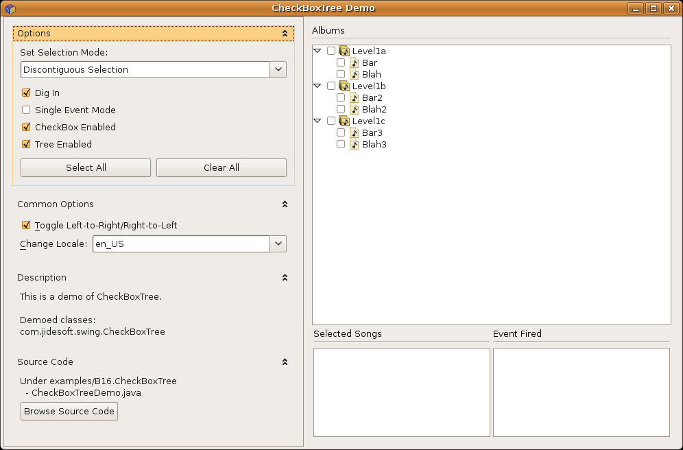

For example,
I have the same tree...and all nodes are UNselected to start.
unchecked intially
I then click level1c - blah3
paths = [[Root, Level1c, Blah3]]
treeSelectionPaths = [[Root, Level1c, Blah3]]
That is correct.
Now click level1a - Bar
paths = [[Root, Level1a, Bar]]
treeSelectionPaths = [[Root, Level1c, Blah3], [Root, Level1a, Bar]]
As you can see paths is not accurate for the entire selection list, but treeSelectionPaths is.
How can I programmatically know which call I need to make to get the correct entire selection list?
In your previous post, you mentioned I need to use paths....that's not accurate in this test case.

Postby JIDE Support » Fri Sep 18, 2009 2:14 pm
You got me. :) We will fix the behavior so that you have a reliable field to use when you get the event.

Postby JIDE Support » Tue Sep 22, 2009 11:58 am
When I tried to "fix" this issue, I eventually figured out that we already had this setting. Please try invoke the following code and respect the treeSelectionPaths you get from the current selection model.
        _tree.getCheckBoxTreeSelectionModel().setSingleEventMode(true);

Postby hemna » Mon Sep 28, 2009 4:12 pm
Thank you very much, that seemed to have made the tree act sanely :)
