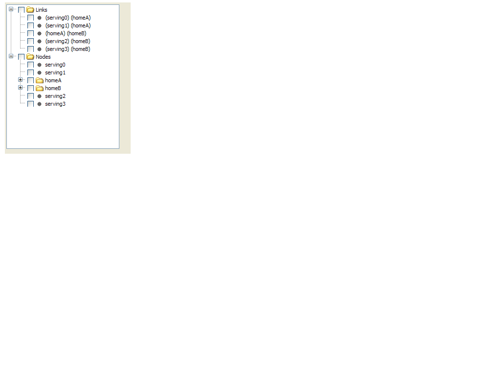

In my CheckBoxTree I am getting a problem where the very bottom of the checkBox is not visible. If anyone can help me fix this I would very much appreciate it.

I attached an image of the problem... As you can see the bottom of every check box is cut off.

Looks like this is a row height issue from the image you post. Please try invoke CheckBoxTree#setRowHeight() and see if it could solve your issue. If it does, please try debug to see if you invoke that method anywhere else. We would have to ask for a test case if you didn't invoke that method at all and get this issue.

Thank you very much, that fixed it
