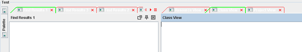

Jide Tabbed Pane "Tab Header Color"
Postby rathinamsm » Tue Mar 20, 2012 9:29 pm
Hi team,
1. As I mentioned in the First Post, if I set The TabbedPane setBackgroundColorAt(); and Application Backgroud as Same, The tab header border is hard to visible.
Please help to achive this tab header border. (Please Refer Picture Jide Post_1.PNG, Jide Post_2.PNG).
2. The Third Jide_post_3 picture shows, that the Yellow Colored box, (setTabResizeMode() - NONE/FIX).in TabbedPane. Is Not Displayed. If we Extended the Dockingmanager and FrameContainer as you suggested.
We applied the setTabResizeMode in TabbedPaneCustomizer().
_panel.getDockingManager().setTabbedPaneCustomizer(new DockingManager.TabbedPaneCustomizer() {
Jide Post_3.PNG (2.68 KiB) Viewed 118052 times
Jide Post_2.PNG (1.04 KiB) Viewed 118052 times
Jide Post_1.PNG (807 Bytes) Viewed 118052 times
rathinamsm
Posts: 40
Joined: Wed Nov 02, 2011 5:36 am
Re: Jide tabbed pane close icon Highlight
Postby JIDE Support » Wed Mar 21, 2012 10:10 am
1, to change the color of the border, please try to manage the color theme in the UI class. The sample code is included in the attached class FrameContainerTest.
2, the resize mode does not have any problem itself. The issue resides on how we override FrameContainerTest#createNoFocusButton(). It's also modified in the attached class FYI.

Postby rathinamsm » Tue Mar 27, 2012 5:04 am
Hi Team,
I worked based on your idea for highlighting the selected and unselected tab with border.
We successfully set the Selected and Unselected border color, tab Foreground color also sets successfully. But we Unable to set the "tab header Background Color".
Please check the overridden method. Is the approach is correct in paintBackground() for setting the foreground and background color.
Please see the attached Screen Shot_1,

Postby rathinamsm » Mon Apr 02, 2012 12:51 am
Hi Team,
I tried to set the background and foreground to jidetabbedpane as you specified by the setForegroundat(), and setBackgroundat(). in the following ways.
1.Setting the TabbedPane Customizer addChangeListener();

Please see the Screen Shot_01, in that the setBackgroundAt(), color is not repainted.
Only the foreground is repainting in resetskin().
How can i able to resolve this problem?
Is Any way to set Background for tab?
Screen Shot_01.PNG (9.23 KiB) Viewed 117983 times

Postby JIDE Support » Mon Apr 02, 2012 10:41 am
Please let your ExtendedJideTabbedPaneUI extends VsnetJideTabbedPaneUI.
