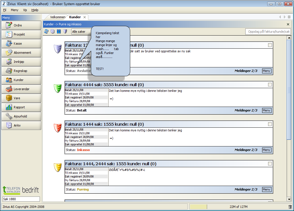

First time i display a balloon tip it is not shown in the correct location:
first display
display code:
                        System.out.println("Component: "+eventText.getText()+" x=" + e.getX() + ", y=" + e.getY());
                        balloon.show(eventText, e.getX(), e.getY());
output from console: Component: Betalt 25/11/08 x=43, y=0
witch shows it is supposed to be rendered
correct display
all subsequent shows will render it correctly.

The component it is supposed to be rendered on is a JLabel placed in a JPanel with a GirdLayout that again is wrapped north in a BorderLayout and then put inside a JSplitPane
any suggestions to what could cause this? Could this be fixed?

Postby JIDE Support » Sat Nov 29, 2008 9:31 am
Sorry for the late reply as it is thanksgiving holiday in US.
Could you please send us a complete test case so that we can look further? Your posted code uses ZPanel which we are not sure where to get it. The other thing is JTextArea could be problematic (as always). You may set the number of columns first before displaying it so that it gets a definite size.

this produces the same bug.
natit
Joined: Thu Nov 13, 2008 4:04 am
Re: BalloonTip display problem
Postby natit » Fri Jan 08, 2010 5:31 am
The first time you push a button it will render the tip about 20-30 pixels down on the button, if you push again (before the 3 second timeout), it will move it to the top of the button.
i would expect it always to render it to the top of the button.

Postby JIDE Support » Fri Jan 08, 2010 11:23 am
Try not to call packPopup.
Postby natit » Mon Jan 11, 2010 1:15 am
The problem persists without a call to packPopup aswell
natit
Postby JIDE Support » Mon Jan 11, 2010 12:46 pm
Thanks for bug report. We will fix it in 2.8.3. For now, please try to invoke simpleAlert.show() twice to work around.
Postby JIDE Support » Fri Jan 29, 2010 12:27 pm
Just so you know, this is fixed in 2.8.3.
