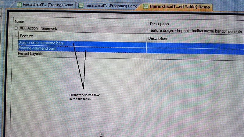

Postby s.durmus » Sun Nov 19, 2017 11:22 pm
Hi;
I use hierarchicaltable in my code and main row has many sub rows. I want to get the rows that are selected in the sub table.
How can I do it.
Thanks.Have a nice day!

Re: HierarchicalTable sub table selected rows
Postby JIDE Support » Mon Nov 20, 2017 7:35 am
You will have to ask the child table to get its selected rows. The HierarchicalTable doesn't know anything about its child components.
Postby s.durmus » Tue Nov 21, 2017 4:26 am
Can you explain in more details.
Postby JIDE Support » Wed Nov 22, 2017 10:19 am
Not much. It should be pretty straightforward. Since you created the child table using HierarchicalTableComponentFactory, you should have access to those child tables yourself. Just call the corresponding methods on those tables to get what you wanted.
