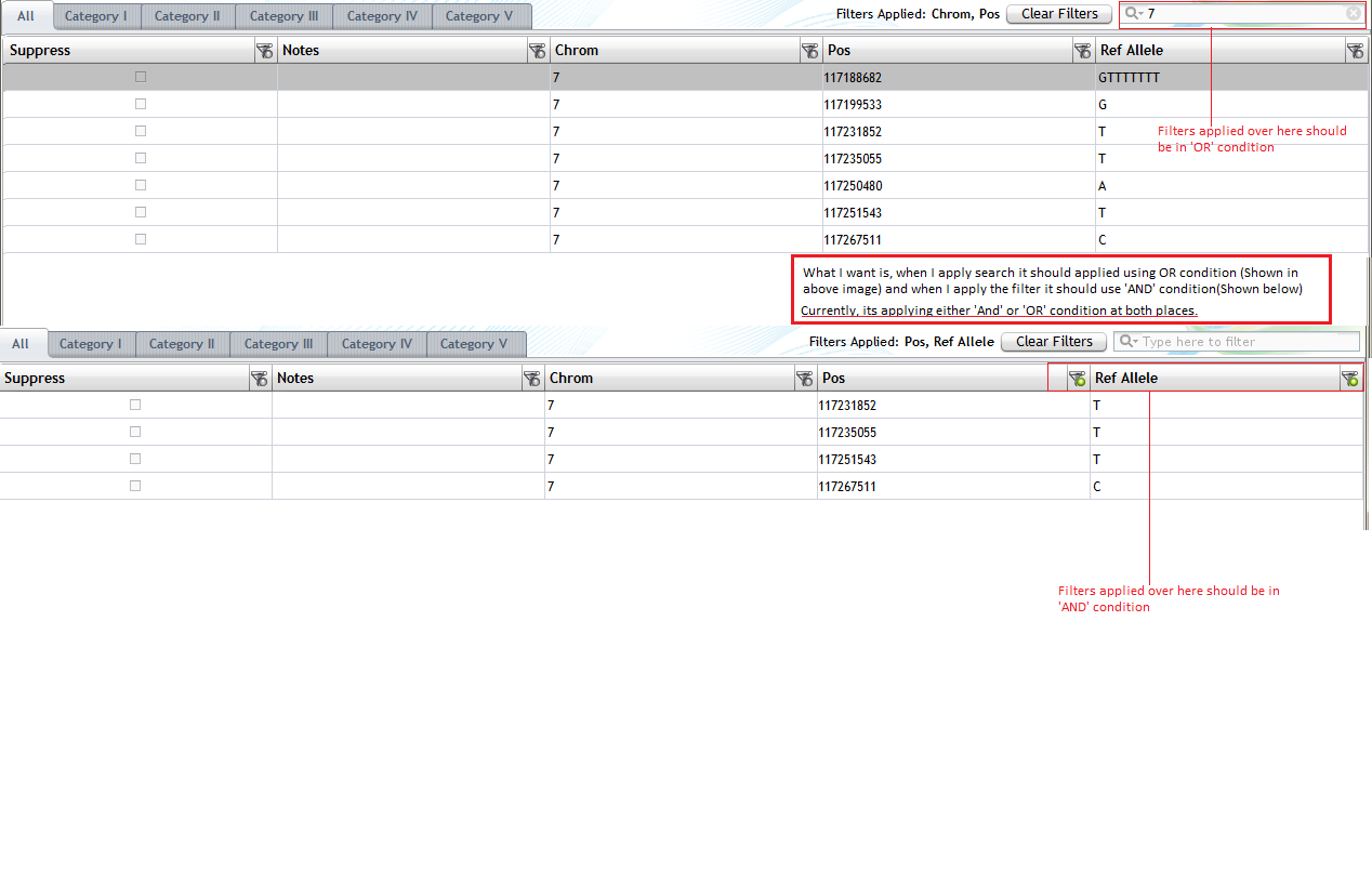

Postby pasalkarsachin1 » Tue Jul 02, 2013 1:53 am
Please see the below image for more clarification.
Code snippet:

Postby JIDE Support » Tue Jul 02, 2013 8:37 am
In this case, you just need two FilterableTableModel. The order is the actual model -> FilterableTableModel used by AFTH -> FilterableTableModel used by QTFF where "->" means wraps or you can consider the data flows from the inner mode to the outer model. The last QTFF FilterableTableModel is set to the table. The two FilterableTableModels will be in AND logic because one wraps the other (no need to call setAndMode). Right now because AFTT will reuse the FilterableTableModel if there is one which is causing the problem that only one FilterableTableModel is used in your code. To workaround it, just use the code below to replace the line which creates the AFTH.
AutoFilterTableHeader header = new AutoFilterTableHeader(this.vcfTable) {
            protected IFilterableTableModel createFilterableTableModel(TableModel model) {
                return new FilterableTableModel(model);
Please move the code from
this.filterField = new QuickTableFilterField(this.vcfTable.getModel()){
to
this.filterField.setShowMismatchColor(true);
to somewhere before
Re: How to set different filtering option

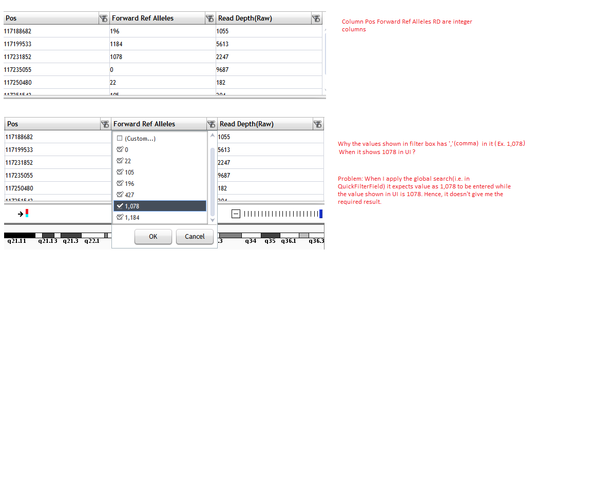

Postby pasalkarsachin1 » Thu Jul 04, 2013 3:50 am
Thanks a lot for above solution.
However, I have encountered one more problem. When I search using QTFF for numeric value, QTFF expects ','(comma) for the value(e.g. 1,078), whereas the value shown in table is 1078.
PFA for further clarification.

Postby JIDE Support » Thu Jul 04, 2013 8:26 am
The JIDE Grids has a centralized ObjectConverterManager which takes care of all the value <-> string conversion. It looks like you didn't use this ObjectConverterManager in your table but we are using it in QTFF and AFTH. If you want a quick fix, you can call NumberConverter.setGroupingUsed(false). However a more elegant way is to for you to setup the ObjectConverterManager according to your need and let your table model implementing ContextSensitiveTableModel interface so that it will use the ObjectConverterManager too.
