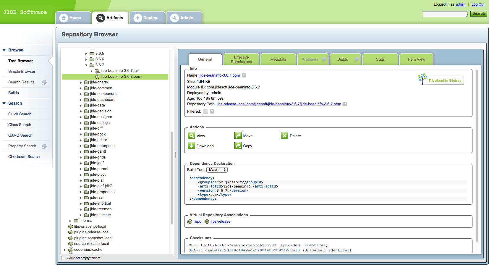

Postby mickael » Mon Feb 16, 2015 4:10 am
I'm using the repository artifactory provided by jidesoft.
I success to download V3.6.7 of most of jars but some seems to be unreachable.
[WARNING] The POM for com.jidesoft:jide-beaninfo:jar:3.6.7 is missing, no dependency information available
[WARNING] The POM for com.jidesoft:jide-dashboard:jar:3.6.7 is missing, no dependency information available
[WARNING] The POM for com.jidesoft:jide-designer:jar:3.6.7 is missing, no dependency information available
[WARNING] The POM for com.jidesoft:jide-diff:jar:3.6.7 is missing, no dependency information available
[WARNING] The POM for com.jidesoft:jide-gantt:jar:3.6.7 is missing, no dependency information available
[WARNING] The POM for com.jidesoft:jide-pivot:jar:3.6.7 is missing, no dependency information available
[WARNING] The POM for com.jidesoft:jide-plaf:jar:3.6.7 is missing, no dependency information available
[WARNING] The POM for com.jidesoft:jide-plaf-jdk7:jar:3.6.7 is missing, no dependency information available
[WARNING] The POM for com.jidesoft:jide-properties:jar:3.6.7 is missing, no dependency information available
[WARNING] The POM for com.jidesoft:jide-rss:jar:3.6.7 is missing, no dependency information available
Is there a problem with these jars ?
mickael
Posts: 98
Joined: Mon Sep 06, 2010 3:07 am
Re: Maven Repository for Jide Jars.
Postby JIDE Support » Tue Feb 17, 2015 12:00 pm
They are in the repository as usual, you can check it by browsing the artifacts as the attached image. However, our server had an issue several days ago. Would you please have a try again? and let us know if you still have this problem.
--Thanks,
Screen Shot 2015-02-17 at 10.53.52 AM.png (272.64 KiB) Viewed 1244813 times
Postby mickael » Wed Feb 18, 2015 12:05 am
I saw the post about the artifactory connection problem.
I cannot open your artifactory in my browser due to a firewall on my side.
I retry to download artifact and this time it was a success.
I don't know if it was a timeout on my artifactory or if you have done something but the problem is solved.
