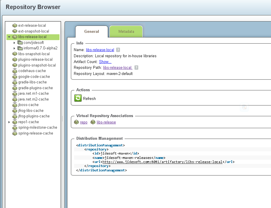

Checked the repository configuration, found out that the two urls
http://www.jidesoft.com:8081/artifactory/repo
http://www.jidesoft.com:8081/artifactory/libs-release
reference to the same site ( it can be verified by opening the urls in browser ). Actually, both of them are virtually associated with the same local repository (see the attached screen shot).
Tested the pom configuration mentioned by Christian, it did no work with both urls on our end. It will work with both urls if the mirrorOf configuration was changed from jide* to *. I tried to get a solution by reading the mirror reference at maven.apache.org/guides/mini/guide-mirror-settings.html. Unfortunately, have no lucky to figure it out. Please let us know if anyone know the trick.
Would like to recommend the following configuration by now, since it is working for Christian.
<?xml version="1.0" encoding="UTF-8"?>
<settings xsi:schemaLocation="http://maven.apache.org/SETTINGS/1.0.0 http://maven.apache.org/xsd/settings-1.0.0.xsd" xmlns="http://maven.apache.org/SETTINGS/1.0.0"
    xmlns:xsi="http://www.w3.org/2001/XMLSchema-instance">
  <servers>
    <server>
      <id>jidesoft-repos</id>
      <username>username</username>
      <password>password</password>
    </server>
  </servers>
  <mirrors>
    <mirror>
      <name>jidesoft-repos</name>
      <url>http://www.jidesoft.com:8081/artifactory/libs-release</url>
      <mirrorOf>*</mirrorOf>
    </mirror>
  </mirrors>
</settings>
