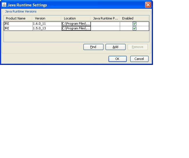

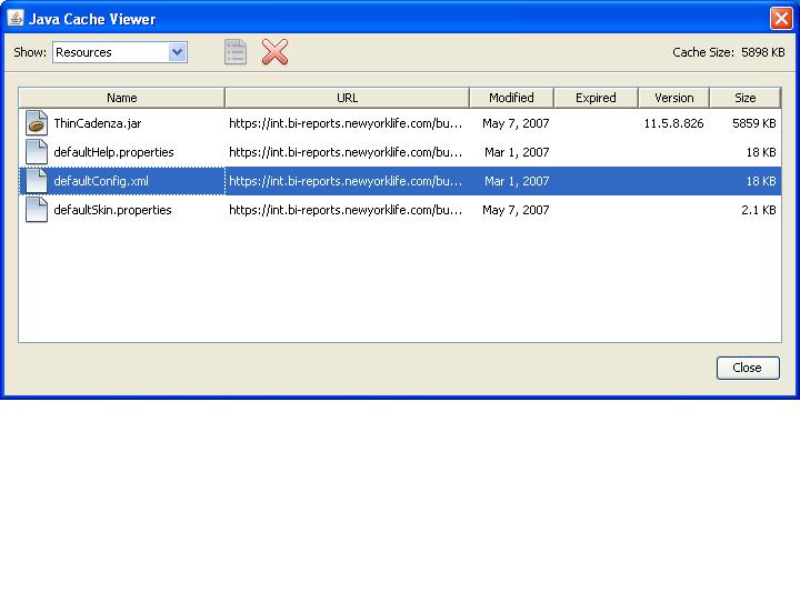

Postby knatesan » Mon Jul 13, 2009 7:27 am
Closed all the browsers.
I did the cache clean.
Started the new browser.
Made sure the JRE 1.6.0_11 is selected. The JSR 1.5.0_13 was also there ( I have tried with this selected and deselected and JRE 1.5.0_13 uninstalled)
The behavior is exactly the same.
I am attaching the
selected JRE, loaded files in Java Cache from Java Control Panel as JPEG file
The Java Console output the Error text.
I strongly believe there is a difference in loading the jar files in the applet with JRE 1.6.0_11.
The interesting part is if I deselect JRE 1.6.0_11 and select 1.5.0_13 everything is fine!!
If you let me know what the porblem could be I would appreciate it.
Java Cache.JPG (43.63 KiB) Viewed 57868 times
JRE Selection.JPG (27.75 KiB) Viewed 57868 times

Postby deklotz » Mon Jul 13, 2009 7:40 am
I haven't read through all of your posts, but as a matter of course when faced with a problem as you describe, I start ruling out everything that I can. I suggest temporarily upgrading your java 6 to the very latest version to see if the problem changes. If the problem stays the same then you can at least tentatively rule out a JVM issue.

Postby knatesan » Mon Jul 13, 2009 8:04 am
I suspected that as well and tested with JRE 1.7.0. I had the same error message.
