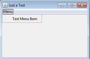

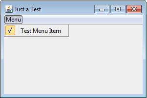

Postby rbakhru1 » Thu Sep 27, 2012 12:22 pm
See attached images
This is how it looks (correct) if we add LookAndFeelFactory.installJideExtension(LookAndFeelFactory.VSNET_STYLE_WITHOUT_MENU)
after the UIManager call in the test code earlier in this thread.
This is the version without the installJideExtension call

Postby JIDE Support » Thu Sep 27, 2012 1:11 pm
If you don't explicitly invoke LookAndFeelFactory#installJideExtension(), JIDE will automatically call it for you. That's how the behavior differs. Please always invoke LookAndFeelFactory#installJideExtension(LookAndFeelFactory#VSNET_STYLE_WITHOUT_MENU) if you don't like the check box behavior.
