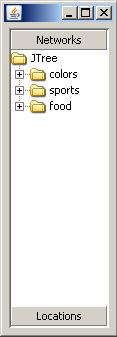

Normal usage of FloorTabbedPane:
Usage of FloorTabbedPane in our application
If you see the above attachments its clear that the normal behaviour is what we want, but unfortunately with in our application it changes to white colored tabs, no matter what ever we do the color of the tab does not get changed to the normal color, do you know what exactly could be the problem.

That's strange. Can you reproduce the second screenshot in a separate test case? I suspect in your application, someone is setting the button opaque property to false.

One thing that I noticed is the default behaviour of the tabbedPane buttons is set to opaque false.
In the image 1 that i attached thats a simple java program which has the buttons color set to the panel color, i thought it was the default behaviour of the tabbedPane buttons.
now i set the opaque to true, i see the real color of the buttons and they are the JideButton colors. I have attached the sample code below which does the same.
Can we set the default proeprty for the application, so that where ever the JideButton is created in FloorTabbedPane set the opaque to true? This would make my application to have the same button color through out, so that it does not depend on the background color on which it is placed, I am not good at framing sentences, Please let me know if the above is not clear.

Postby aryanarvind » Fri Oct 24, 2008 8:03 am
I think I figured out what the issue was with the color ofthe tabs, I was adding the tabbedPane directly to the DockableFrame, which had a background color as while and unfortunately all other tabbedPanes in our application were added to a JPanel, now here i saw the difference and made the change accordingly. Now the tab colors are same as others with in the application.
I would think that the default behavior must not be dependent on the parent panel but unfortunately its behaving that way now, I think its a good idea to turn on the opaque property over the JideButton while creating the FloorTabbedPane.
