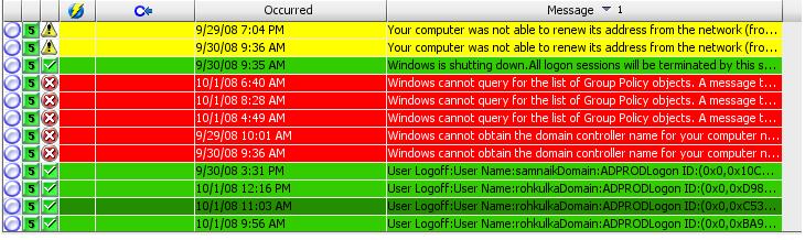

Postby rohan26may » Wed Oct 01, 2008 12:10 am
I need a fancy looking JTable component. Does Jide provide such component or a remedy so that I can make my JTable look Fancy?
Attached JTable.bmp is how my JTable looks currently and row.bmp is how I want my JTable rows to look like so that It's better readable to the customer.
Can you please suggest me a solution?

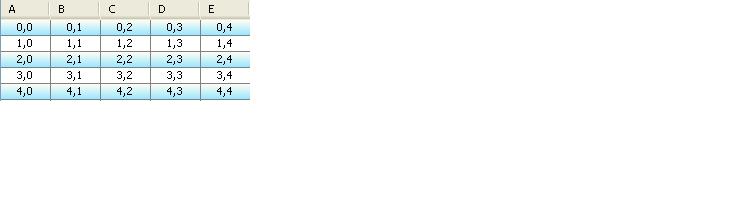

Re: Does JIDE provide a JTable like component?
Postby rohan26may » Thu Oct 02, 2008 8:34 pm
I have attached the files again. Please find them.
This is how I want my JTable's rows/cells to look like (i.e. with shaded colors)
This is how my JTable looks like.

I tried referring GradientStyleTableDemo.java file but I couldn't successfully create the table that I wanted.
Please see attached. That is what I want to achieve. Can you please shed some light on how can I get only that. (Possibly provide me the exact code :) )
The file has lot of code that I dont understand what its doing. Kindly assist.

_cellStyle.setEndColor(BACKGROUND2);
_cellStyle.setVertical(false);
else {
_cellStyle.setStartColor(null);
_cellStyle.setEndColor(null);
_cellStyle.setVertical(true);
else {
if (row % 2 == column % 2) {
_cellStyle.setStartColor(BACKGROUND1);
else {
return _cellStyle;
public boolean isCellStyleOn() {
return _pattern != 4;
rohan26may
Posts: 6
Joined: Thu Sep 25, 2008 1:51 am
Postby JIDE Support » Mon Oct 06, 2008 7:00 am
We have radio button to change the _pattern field to different values. But in your code, it is always 0.That's the reason not working. Note isCellStyleEnabled method. It always return false in your code. You can manually change the _pattern value to 0 to 4 and then compile and run to see the difference.
Users browsing this forum: No registered users and 86 guests
