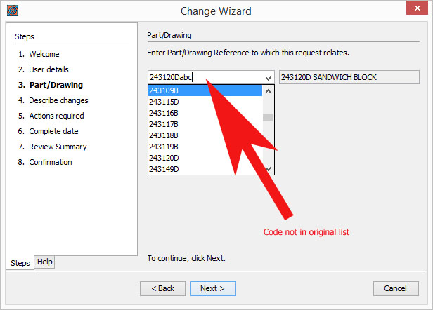

My AutoCompletionComboBox is initialized with a list of part numbers: "AAA", "AAB", "AAC".... "ZZZ".
The AutoCompletionComboBox is not Strict so the user is free to type a code not in the initial list: e.g.: "WXy123" In this case, I want to capture the text "WXy123" and preform some other action with this as a parameter.
How do I capture the text "WXy123"?
The normal call to AutoCompletionComboBox#getSelectedItem(); returns the closest match from the original initial list and NOT "WXy123".
Maybe the attached screenshot will help.
Regards, David

Re: Autocompletion - how to detect item NOT in list.
Postby JIDE Support » Tue Apr 14, 2015 9:32 am
If you want to detect what user typed in the text field, you will have to use textField.getDocument().addDocumentListener.
