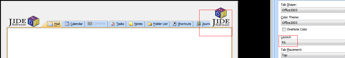

we are using JideTabbedPane, and if I use the "fit" mode of the tabbed pane, the last tab is covered by a trailing component, if I resize the window.
This happens before the tabs shrink.
This is quite annoying, because it might happend that the last tab is hidding completely.
Is there any workaround?

Thanks for the bug report. Will try to fix it in later releases and keep you posted.

Just so you know, this is fixed in 3.5.8 just released.
