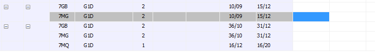

DataTable is in own ScrollPane for horizontal scrolling. So selected cells of DataTable can be hidden and disappear. RowHeaderTable on left side is fixed and user should reconstruct which row is selected. So the code above works, but it would be fine, selection of rows of RowHeaderTable would use whole width of RowHeaderTable.
Picture show RowHeaderTable and selected DataTable

Postby JIDE Support » Mon May 07, 2012 8:45 am
You could invoke HeaderTableModel#getCellSpanAt() first to get the spanned rows for a cell in the row header table. Please then check all the rows in the DataTable to determine if the cell in the row header table should be selected.
