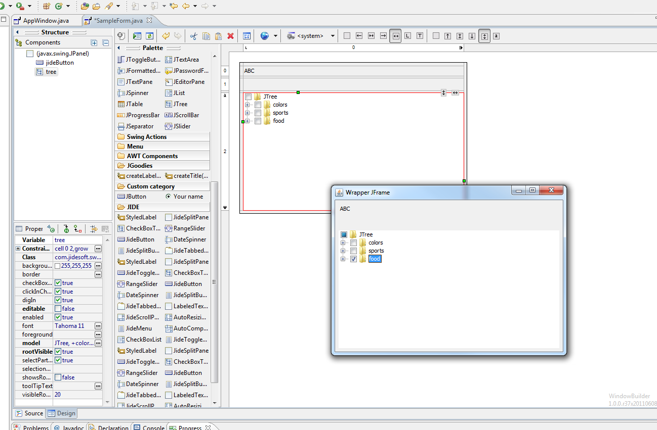

BTW, you may need to restart eclipse after importing jar. It might be a bug in eclipse.
See a screenshot below.
1-6-2012 9-51-42 AM.png (137.08 KiB) Viewed 33590 times

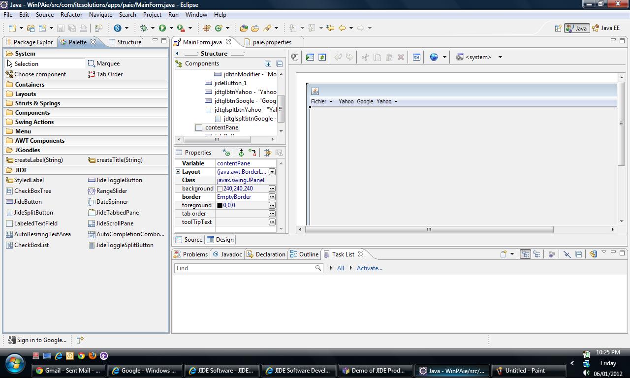

It works, However it looks like some of the components are missing , I downloaded the latest 3.2.2 jar file here is what i see in the palette
see attached file for the list of components available.
Badis
please see palette in the attached file.

Postby JIDE Support » Sat Jan 07, 2012 10:26 am
Actually you got all the components we defined in manifest.mf file inside jide-common.jar. I just noticed in my screenshot, there are duplicates which is why it appears more than you got. It is probably because the component didn't show up when I imported, so I imported the jar several times until I found after restarting eclipse, the components show up. There are probably more components that can be used inside the windowbuilder and we will update the manifest.mf accordingly.
