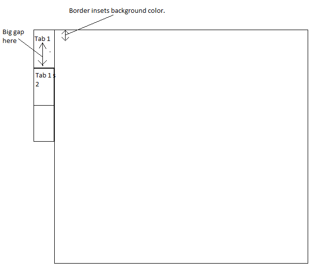

When I used JideTabbedPane in the left, It cause a few of layout problems:
First, tab title was rotated but the tab area was calculated with rotated text and make a big gap in every tab. At this point, I want JideTabbedPane keep the text direction but the gap must be removed.
Second, the tab title always cut down if it is too long. I want the tab will stretch with the tab title or wrap it to multi-line. I tried to setTabComponentAt but this method does not affect.
Third, the background color of content border insets can not be controlled.
This problem can be solve by easier way or I have to custom the BasicJideTabbedPaneUI class for my own tabbed pane.

Can you please give JIDE JideTabbedPaneDemo a try? The layout is correct when the tab is placed at left.
Regarding the content border insets, please give the following code a try.
        _tabbedPane.setTabColorProvider(new JideTabbedPane.ColorProvider() {
            public Color getBackgroundAt(int tabIndex) {
                return Color.blue;
            public Color getForegroudAt(int tabIndex) {
                return null;
            public float getGradientRatio(int tabIndex) {
                return 0;
