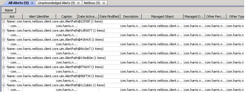

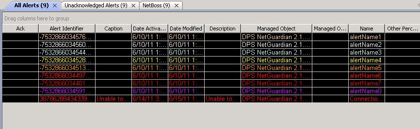

Hi, I have a GroupTable which each column has defined a custom CellRenderer like this:
        GroupTable groupTable = new GroupTable(model);
        int columnCount = getColumnModel().getColumnCount();
      for (int i = 0; i < columnCount; i++) {
         final TableColumn tableColumn = getColumnModel().getColumn(i);
         TableCellRenderer renderer = controller.getCellRenderer(i);
              renderer = AlertView.cellRenderer;
                        tableColumn.setCellRenderer(renderer);
the first time I see the table is correct, all records are displayed as they are defined in the renderer, but when I group the table by a field, apparently is not applying the custom renderer any more.
Is there any way to implement custom renderer when a grouping is done.
The screenshots of the table before/after are attached.
Robertho.

Cell renderers configured to TableColumn will be reset on table structure changed event. That's why it happens. Please try to implement JIDE technologies including CellStyle, ObjectConverterManager, CellRendererManager so that your setting could be persisted during grouping/ungrouping. Please check out the developer guide at http://jidesoft.com/products/download.htm for details.
