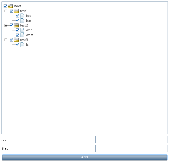

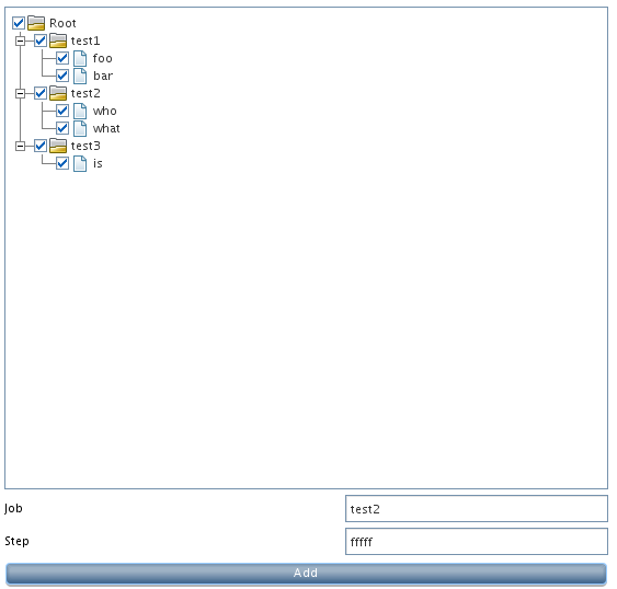

So that is my code for inserting a node. When I run the applet in eclipse, I can see the new node being added into the existing nodes that I find,
but they don't show up in the tree from what I can see.
This is a screenshot of just prior to me adding the new entry.
This is after I a call the insertNewTreeNode() method.

Postby JIDE Support » Fri Sep 11, 2009 4:19 pm
That's not the correct way. You should use DefaultTreeModel#insertNodeInto method.
Re: CheckboxTree
Postby hemna » Fri Sep 11, 2009 4:27 pm
excellent thank you. That worked like a charm.
